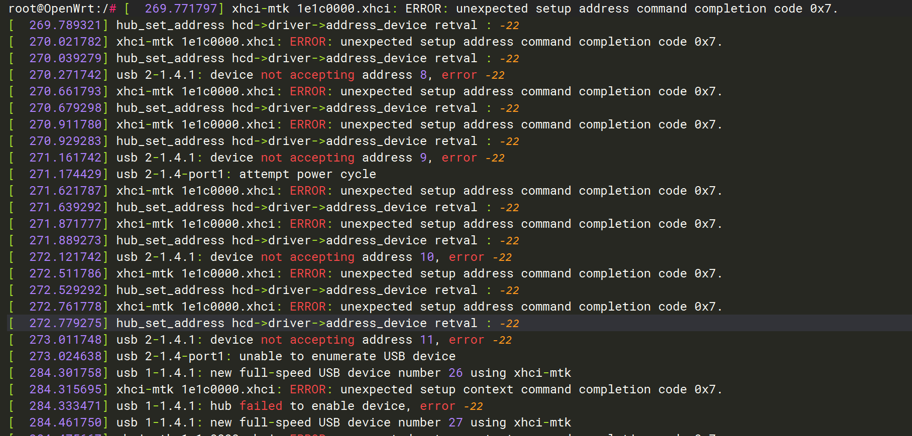

我现在有个hub挂在了7621的3.0口上,hub上挂载了两个usb设备,7621的2.0usb口上挂了一个usb设备,当我再给hub插第4个usb设备的时候,报如下错误:感觉是地址无法再分配出来了,我们从内核里发现,内核打印说最多支持15个设备!
[ 270.271742] usb 2-1.4.1: device not accepting address 8, error -22
[ 270.661793] xhci-mtk 1e1c0000.xhci: ERROR: unexpected setup address command completion code 0x7.
[ 270.911780] xhci-mtk 1e1c0000.xhci: ERROR: unexpected setup address command completion code 0x7.
[ 271.161742] usb 2-1.4.1: device not accepting address 9, error -22
[ 271.174429] usb 2-1.4-port1: attempt power cycle
[ 271.621787] xhci-mtk 1e1c0000.xhci: ERROR: unexpected setup address command completion code 0x7.
[ 271.871777] xhci-mtk 1e1c0000.xhci: ERROR: unexpected setup address command completion code 0x7.
[ 272.121742] usb 2-1.4.1: device not accepting address 10, error -22
[ 272.511786] xhci-mtk 1e1c0000.xhci: ERROR: unexpected setup address command completion code 0x7.
[ 272.761778] xhci-mtk 1e1c0000.xhci: ERROR: unexpected setup address command completion code 0x7.
[ 273.011748] usb 2-1.4.1: device not accepting address 11, error -22
[ 273.024638] usb 2-1.4-port1: unable to enumerate USB device
1.7k
manro 认证专家 2024-09-24
最大十五个设备应该是协议定义的,但是7621主芯片资源有限,实际使用时无法接这么多设备;
